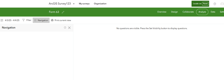

Hello,
Please see the screenshot below. I am using survey123 connect latest version and survey123 web for analyze and data report. How can I turn it on to view for analyze? It is not clear. Please advise. Thank you for your time and support!

Check the Collaborate tab

I'm having the same issue/getting the same message. Were you able to resolve the problem?
Czapiga_Jason
I ran into this recently.
In the xlsx form, my survey began with a group (begin group) question type and included Null in the bind::esri:fieldType column.  Removed the Null and republished. All the questions now display in the Analyze tab.
