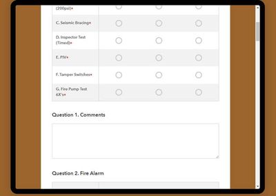

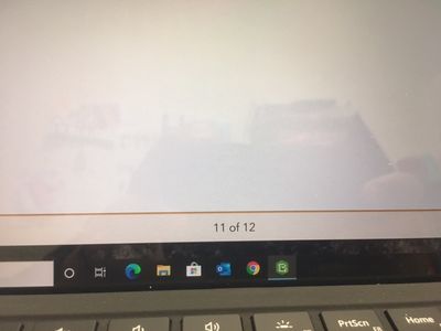

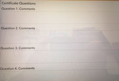

My field user is using Chrome or Firefox to use the surveys in the field until his app version can be fixed, which now is the only one with this behavior. Connect hasn't been used to make or edit the surveys, the app was published in 3.12 but was able to update to 3.13 with no issues. All my users' apps and surveys have 3.13 which we confirmed recently. We set everything to use latest version in July. I was able to edit the pictures to maintain the survey anonymity. First two images are of the errors as was sent to me and the third image is what it should look like. There are also address, signature, text notes, and other kinds of questions involved that also disappeared. I haven't heard from my field users this morning yet but will check in as I can to see if anything has changed. Hopefully the pictures help some.
