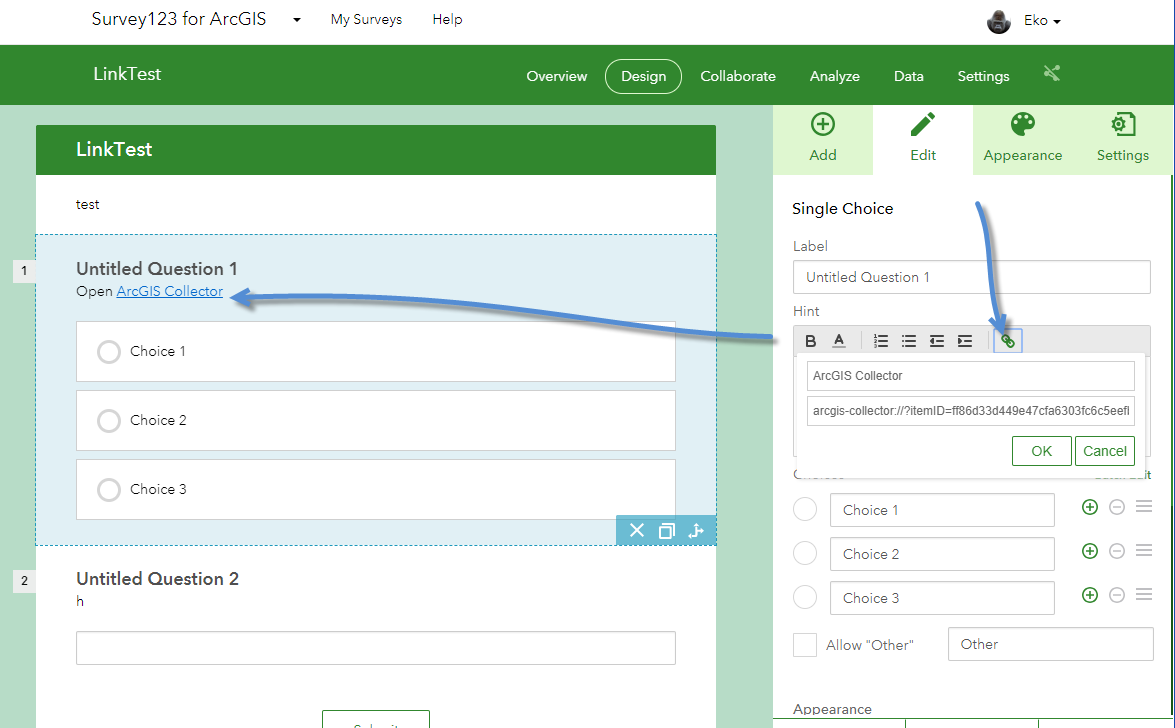

Hello,
I am trying to insert a link to Collector from my survey, and I put it in the label of a note but I keep getting this error when I try to save or publish the survey. Anyone know what I'm doing wrong?

You could put the link in a Hint.

I just used the "add link" that is part of Hint in the Survey123 Web Designer.
For the Link I just enter the custom URL - Applink.
If I open the survey in Survey123 Connect, the Excel sheet shows this for hint column.
