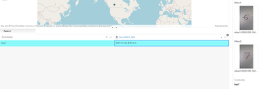

There is nothing there that would prevent those attachments from being sent. Here is a test submission I tried:
So when you say "if the 2 additional photos are taken they do not send", do you mean that they never send? Or that they only don't send some times?
