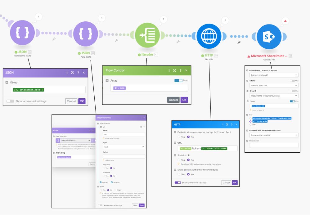

I'm trying to follow this workflow you laid out and can't seem to figure out the Iterator piece.  Do you have any more information on how to pass the JSON to the Iterator?   I've tried about 50 different ways to slice this and I'm not getting any closer.  See below for what I have currently with a Survey123 with 5 file attachments that I'm trying to drop into SharePoint.  The ParseJSON seems to be working because when I run it I can see 5 Bundles with the different url's.  The Iterator just doesn't seem to want to rotate the 5 attachments.  Any help would be much appreciated!!
PaulSweeney3

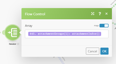

@AaronChisholm1  your iterator should be pointed at the attachments array and you should use the url value from its output in your following scenario. remember the iterator looks for an array to iterate through and provides the values for each element in the array as outputs

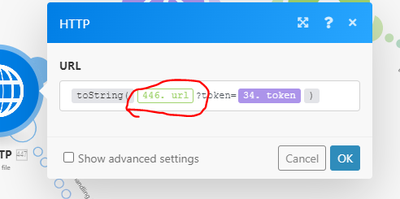

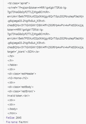

Thanks for the quick response.  That solved that issue.  I can now see all 5 bundles within the Iterator.  But now I'm running into a token issue.  Using what you put above toString(url?token=token) or what I'm used to doing which is url?token=token (see below) - the result is an invalid token html.  Any other thoughts?  I appreciate the help!!
PaulSweeney3
Invalid token would suggest the user has no access to the feature layer with the attachments.Do you have everything shared appropriately?
AaronChisholm1
Yes, everything is shared appropriately.
