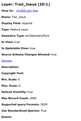

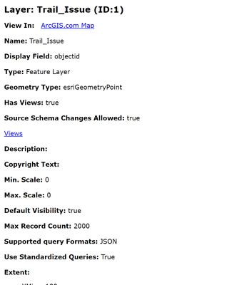

DarraghOSullivan
@Anonymous User @JamesTedrick
These are the layers with features increased to 2000. Do you see anything wrong, or any advice? Thanks.
Layer in Main Feature Service:
Layer in secondary service via Inbox:
