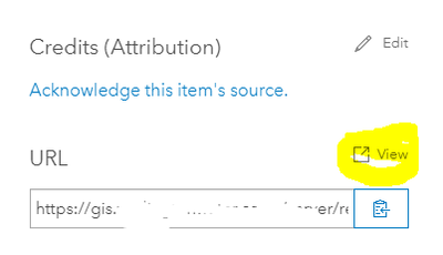

AdministratorWellington_Water
This is what I did and it was successful:
Logged into my Enterprise Portal as the owner of the hosted feature service, which is also an administrator login
Found my hosted feature service
Clicked on the View button at the bottom right, to take me to the Rest end point for the service
Added Admin into the address path:
https://YOUR PORTAL URL/server/admin/services/Hosted/NAME OF YOUR SERVICE/FeatureServer

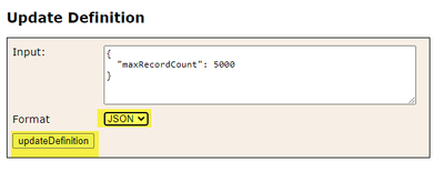

scroll to the bottom and click on Update Definition
Type the following into the box:
  "maxRecordCount": 5000
Then click on UpdateDefinition
