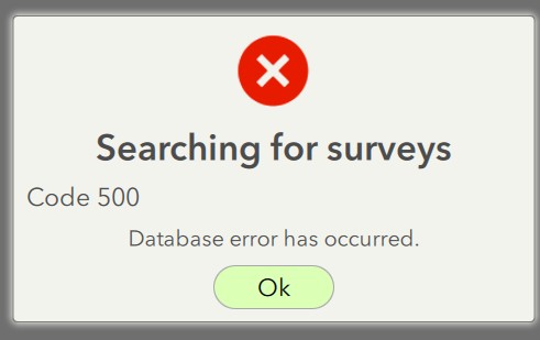

I'm trying the set the inbox filter on a field that is set as a select_one in the form without being able to get the data.
Just for info, In the feature layer (hosted) that field appears as drop-down.
In  the survey123 ArcGIS -> Inbox -> Refresh, I'm getting:
If I do a inbox filter on a text field, I'm able to get the data.
Is there a trick? or is it a bug.
Thanks.

Hi Eric,
There is no such limitation in case of Survey123 and Inbox functionality, the inbox feature works even if it is applied on a "select_one" field. The trick is that the value which is provided as "Query Expression" should be correct. The correct expression should be as follows:
 Name of the field in Survey sheet = 'Name of the option on which filter should be applied'
For eg:
Survey sheet:
Choice Sheet:
Choice Sheet
So the "Query Expression"  might look something like this:
field_5='choice0' (If you want to to filter questions where 'Choice0' is selected)
Hope this help!
