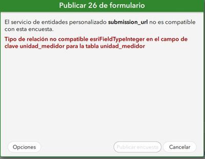

MercedesTettamanti
James, Hi again
We know thart is possible to attach images in a survey from the Inbox, by creating a repeat group, if we create a relationship class between the feature class and a table. Do we have to use a GUID to make the relationship? We failed trying to do it. There is something missing...that we can not solve yet...we always obtain the same error. https://doc.arcgis.com/es/survey123/desktop/create-surveys/survey123withexistingfeatureservices.htm
We do not know how to manage GUIDs Could someone help us?
Which field must be the one to do the join?
Do we have to complete the data of the related field in the child table? Or not?

Hola Marianela, lamentablemente nosotros  no aún no hemos podido resolverlo. Pero hay que seguir buscando la vuelta, porque en principio tiene solución. Slds.
