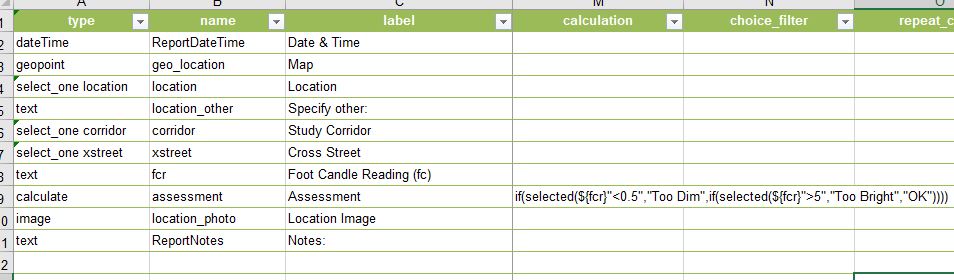

I'm trying to do a Foot Candle Reading calculation for a lighting assessment.  Basically, I need it say "Too Dim" if it's below 0.5, "Too Bright" if it's above 5 and "OK" if it's anything else.
The formula I have in excel is =IF(E6<0.5,"Too Dim",IF(E6>5,"Too Bright","OK"))
I've tried a combination of this:
if(selected(${fcr}"<0.5","Too Dim",if(selected(${fcr}">5","Too Bright","OK"))))
Is this possible or too complicated?

if(${fcr} < 0.5, 'Too Dim', if(${fcr} > 5, 'Too Bright', 'OK'))
Try this and I think it would be helpful if you made fcr a decimal type
