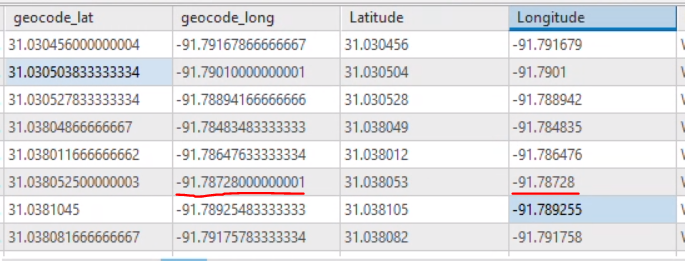

I created a survey in Survey123 Connect that automatically records the coordinates of the point and displays them to the user in a Note field.
I have that note field set to round to 6 decimal places, but in cases where there are zeros at the end of the coordinate, it does not display the zero. Here is an example:
For consistency in the final reports, it is important this this field always have 6 decimal places, even when the last number is a zero. Is there a way to accomplish this?

There isn't a direct number padding/formatting function in the XLSForm; that being said, we should be able to do this in the future with custom JS function (currently in beta) using the .toFixed() method - JavaScript Number Methods
