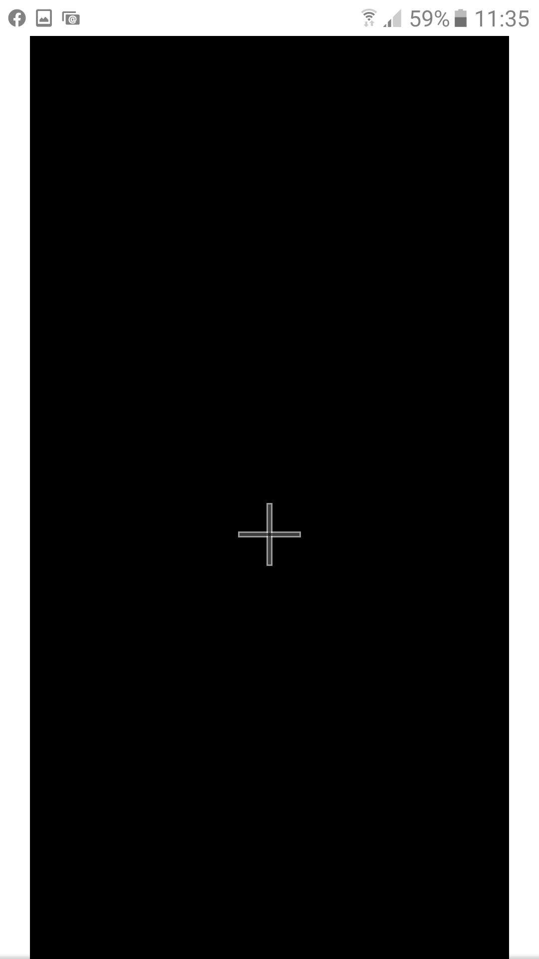

We have a webpage (www.arc-trust.org/garden-dragon-watch), within which we have embedded a survey123 form, built using Connect. The embedded form contains a geopoint question. This displays correctly when the webpage is accessed from a PC or laptop, but not when accessed from some mobile devices / via some mobile browers. When a user clicks on the geopoint question to add their location, the map screen goes black (though the address entry still seems accessible). If the form is opened as a standalone item in a web browser (https://arcg.is/1XieXr0) it performs as expected. Are there any known limitations of browser types supported / unsupported?

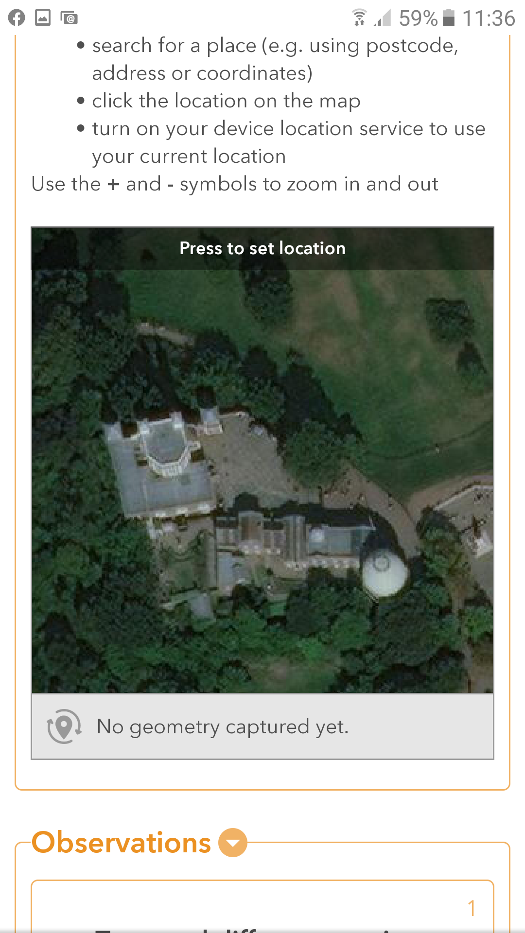

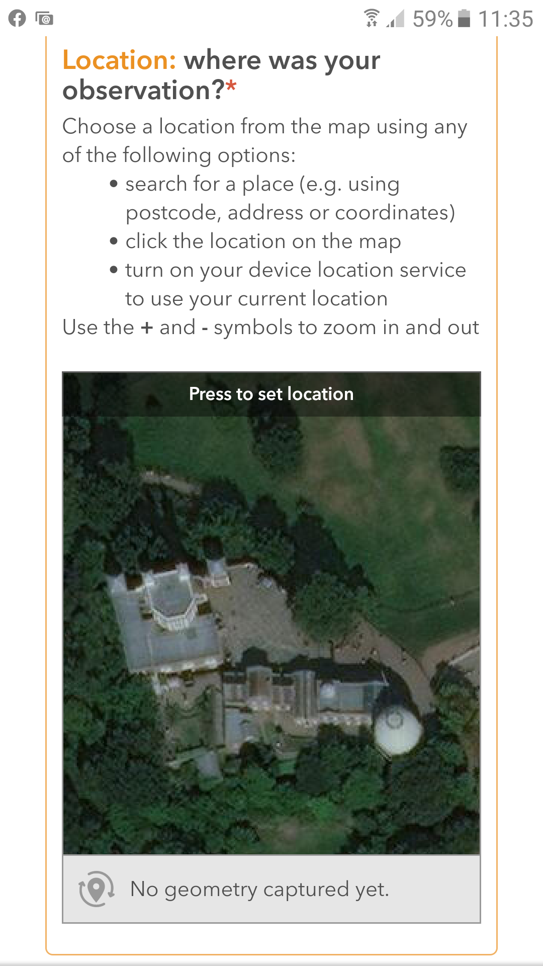

Accessing via the embedded form on our website from a mobile device:

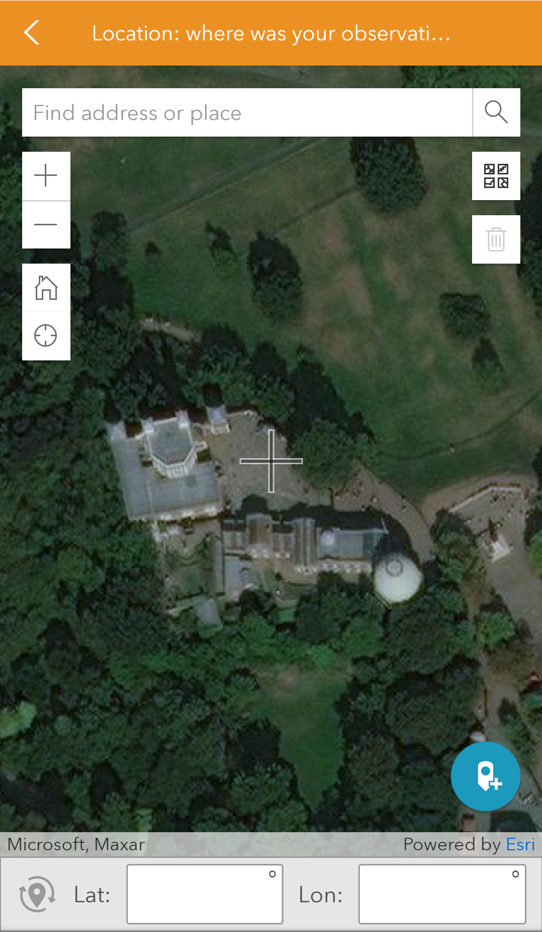

Accessing via the direct link to the Survey123 webform on a mobile device:
As an example, on my own phone (Samsung Galaxy S5 Neo, Android) it does not work in the following browsers:
- Google Chrome version 81.0.4044.138 (address entry displays, but map is black)
- Samsung Internet version 11.2.1.3 (address entry displays, but map is black)
- Microsoft Edge version 45.03.2.4958 (address entry displays, but map is black)
Functions correctly in:
- Mozilla Firefox 68.8.1
