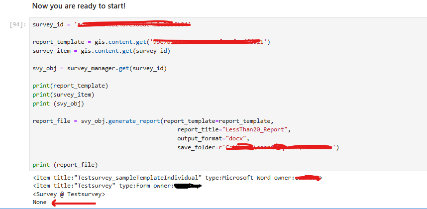

Hello everyone - I had a working script to generate reports on demand in survey123.
But it stopped working.  So I went back to basics, started new, followed the example data...  And I keep getting "none" as a response.  Except once in awhile- it actually outputs something.
I removed Identifying Items in the code below - to see the output, look at the attachments.
It runs fine if I manually trigger it from Survey123
and in my screengrabs, I know the output path is formatted wrong - It will get fixed once it runs as it should.
This is my Initial notebook cell:
import arcgis
import arcgis.apps.survey123
from arcgis.gis import GIS
from arcgis.apps.survey123 import SurveyManager
gis = GIS("home")
survey_manager = SurveyManager(gis)
print (survey_manager)
________________________________
This is my second notebook cell
survey_id = 'IDnumber'
report_template = gis.content.get('IDnumber')
survey_item = gis.content.get(survey_id)
svy_obj = survey_manager.get(survey_id)
print(report_template)
print(survey_item)
print (svy_obj)
report_file = svy_obj.generate_report(report_template=report_template,
report_title="LessThan20_Report",
output_format="docx",
save_folder=r"downloadpath")
print (report_file)

Hey @Carrie2025
Try running your notebook using the latest 2.4.2 version of the ArcGIS API for Python. This was logged as BUG-000179345. It looks like you're running your notebook in a hosted notebook, unfortunately the current runtime version for hosted notebooks uses Python API 2.4.1. At this time to test in 2.4.2 you would need to download the notebook and run in ArcGIS Pro 3.6 or a standalone Python environment.
