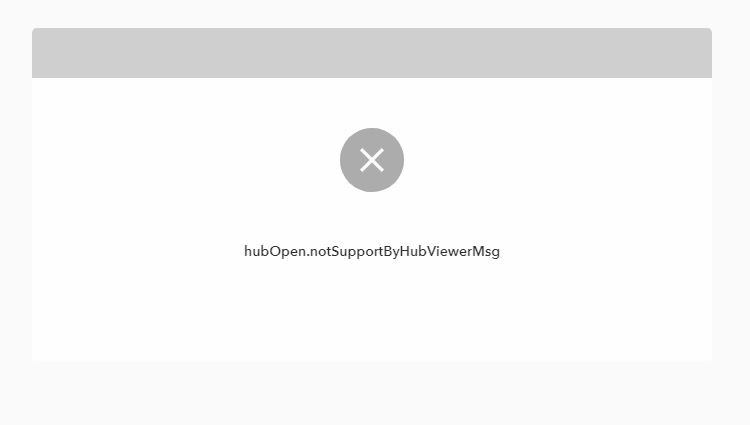

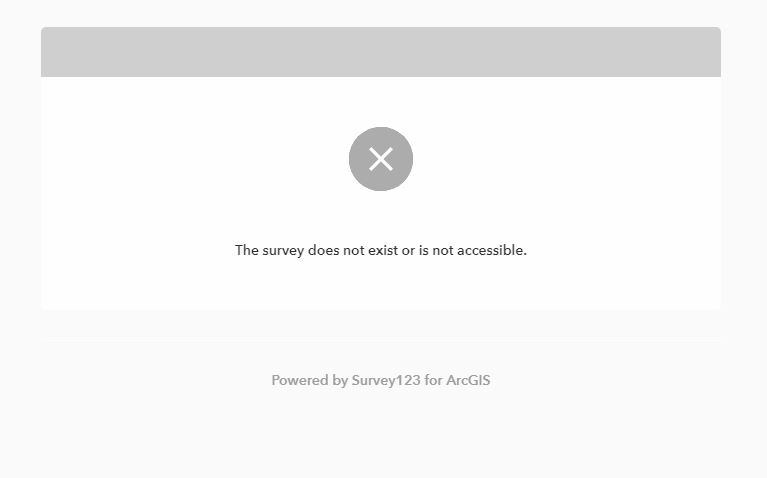

I recently encountered an error that I am not finding a solution for when I attempt to open a form on Survey123. I attached the two error images that I am seeing. I also downloaded the survey content in Survey123 Connect and it looks there is not data in the excel spreadsheet. The survey and feature service data still exists on AGOL which tells me that the Survey still technically exists but the theme tells me something may have been corrupted. Any help would be appreciated.

Errors like the one from your screenshot are often associated with content modification - e.g. i f we updated sharing for the form in ArcGIS Online but not the Hosted Feature Layer (leaving it at private), it would allow users to download the survey form in the Survey123 field app but fail on submission as the users could not access the target Hosted Feature Layer.
On this line of thought, did we rename the Hosted Feature Layer in ArcGIS Online?
Or move it outside of (or rename) the default survey folder created on publish?

Thanks for the information on some of the potential issues that would arise if manipulating the content in the S123 Folder in AGOL. I created the survey under my account and transferred the survey, as well as the feature service layers to another account under my organization for sharing purposes. I think ultimately manipulating the webhook configuration in S123 caused the survey to respond with errors.
