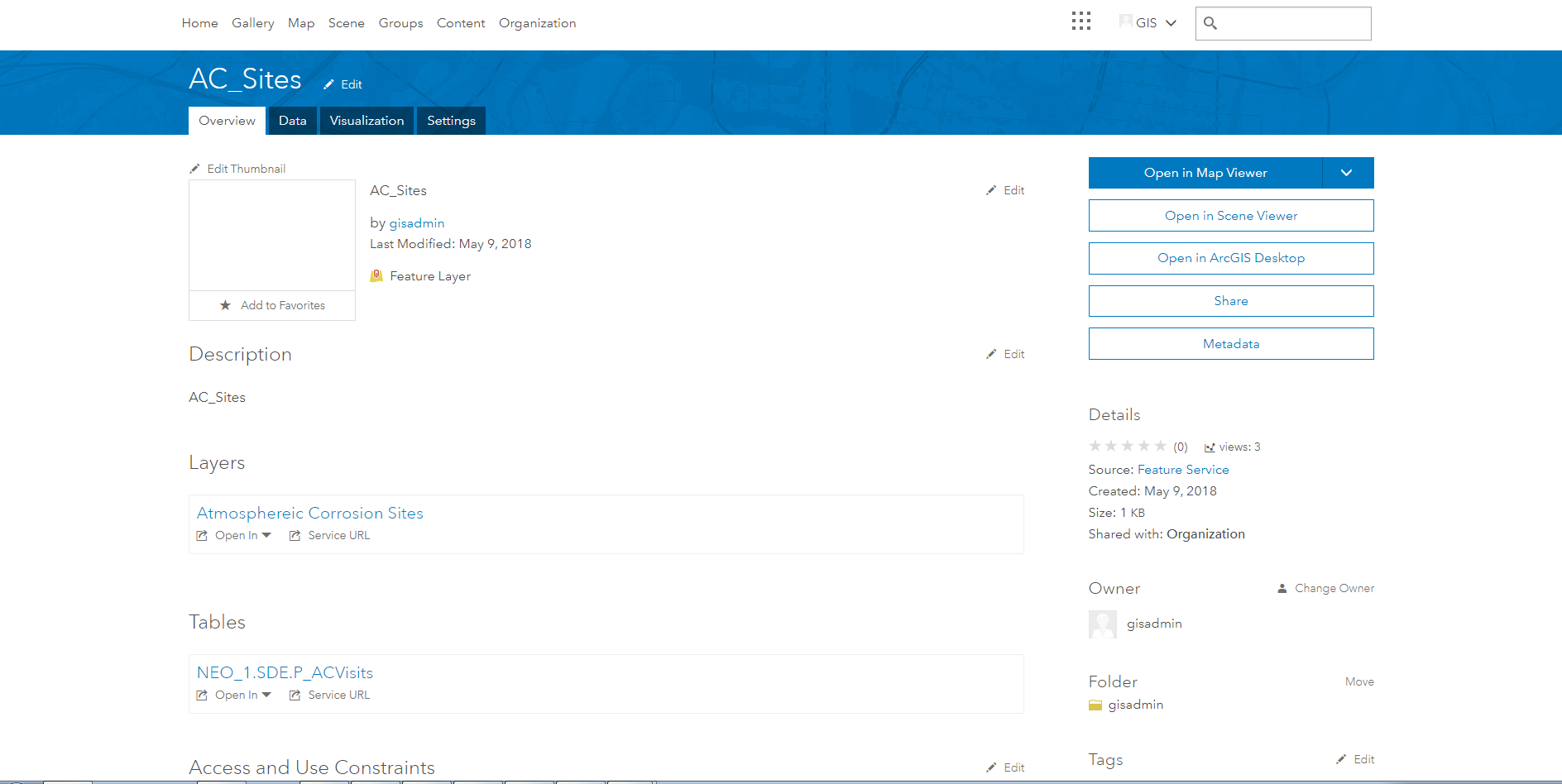

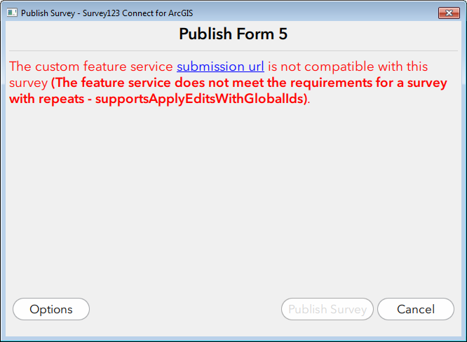

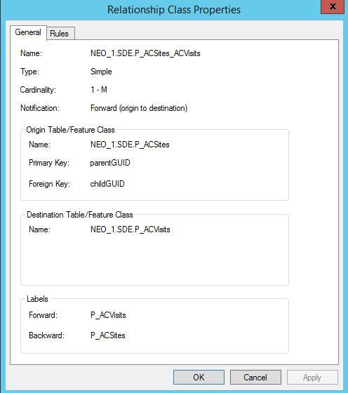

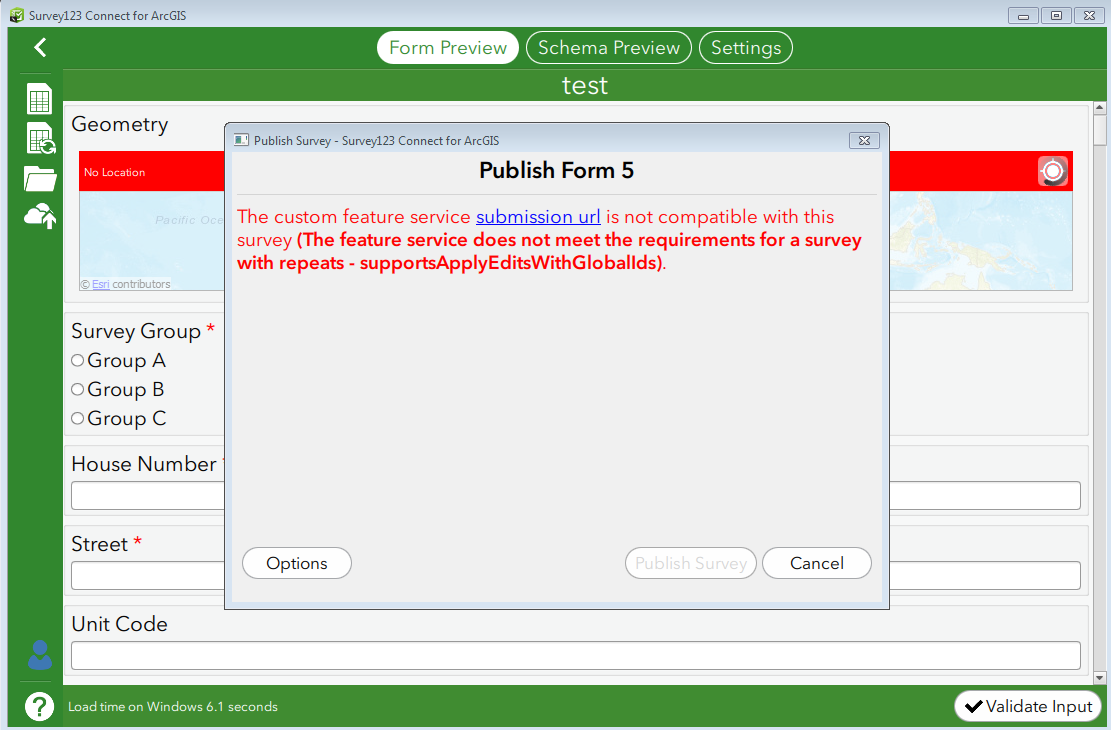

We're trying to setup a survey123 form that's versioned with a feature layer that has a feature class and a related table but while trying to publish in survey123 we get the error in the picture below. They both have Global ID's, editing tracking turned on and archiving enabled. It seems that versioned tables are configured with survey123. Has anyone found a solution for this?

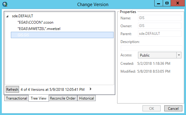

Note - I did try some troubleshooting with a different workflow but it's not practical. If you unregistered version for the layer & table and setup everything again it'll work but users can then write directly to the default version which is bad practice and design. I'll provide our workflow below

Hi Jordan,
Survey123 does not support versioned feature services.
Please take a look at the following Blog which mentions the limitation, and some details related to it here.
