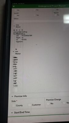

Hello! So we had some field personal bring a device back and claimed the app suddenly began to look distorted. I tried repairing, resetting, and even reinstalling the application and nothing has seemed to fix the issue. I took a look at the settings in the app itself and in Windows and everything appears normal. I do not think it is a settings issue because when you make a selection with the mouse it selects the item where it typically would be, however as you can see from the attached picture, it does not correspond to the window. The distortion is not present with any other application.
Any ideas??

Hello @Anonymous User,
To confirm this behavior is observed with the latest 3.13 release of ArcGIS Survey123 as well right? If so I would also suggest seeing if there are any updates to the graphics drivers on the machine. Please use these links for reference regarding how to check and update the graphics drivers:
http://www.algodoo.com/update-drivers/
https://support.microsoft.com/en-us/windows/update-drivers-in-windows-ec62f46c-ff14-c91d-eead-d7126dc1f7b6
Another thing to try is to use command line parameters to see if changing the rendering engine makes an difference. If you try angle as the rendering engine is there a difference in display?

Hey Zach,
So I think you were correct. Before you had provided a response I made sure everything was updated on the computer. I updated both the BIOS on our Dell Rugged Tablet and any Windows 10 software. After doing that the screen did appear normal again.
Thank you for your suggestions - if the problem occurs again I will certainly look into the other suggestions you made!
