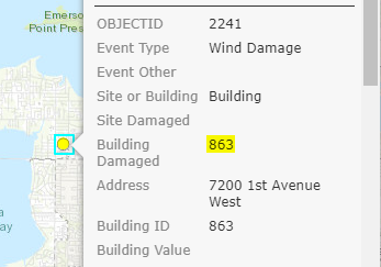

We have a survey where one of the fields use select_one so that users can choose specific buildings from a grouping within the "choices" tab of the xlsx file. The name column of the choices contain the numeric ID number of the building and the label is the name of that particular building (as depicted below).
Within the Survey123 app and web form, everything works great in terms of the labels displaying properly in the drop-down of the question. However, when I pull the feature service into a Portal web map to view the data, the labels seem to get lost and revert to displaying the ID number that was in the name column.
We aren't using choice_filters, nor are there any cascades or repeats in the form. I've read that there was a similar type of issue with Collector a while back, but I wonder if this is similar? Is there a means to fix this so that associated web maps will display the labels?
Thanks in advance for the help!

It appears that the field does not have a domain- that is how the label is normally displayed automatically.  Is this an existing feature service or one created via Survey123 Connect?
LeaHarper3
Deactivated User
Hi James - the survey does use an existing feature service. The field that populates the building name ("Building Damaged") we created as text and then thought the choices tab would be a feasible option, otherwise the domain would contain 800+ options that do change as property is bought/sold/reclassified.

If you're not using domains, then the data you are seeing is what would be expected.  We do have an enhancement open to support a function that would retrieve the label for a choice list; I'll add this thread to the information concerning that enhancement.
