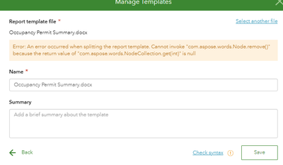

Hello Survey123 Community - when trying to upload a summary feature report, I'm getting this odd error:
Anyone have any ideas on how to begin troubleshooting this?

Hi @AidanDonnelly
It seems couldn't parse the summary section correctly. Could you please check whether the open and close tags of $<$summary>...$</> are placed correctly? https://doc.arcgis.com/en/survey123/browser/analyze-results/featurereportqueries.htm#ESRI_SECTION1_9...
