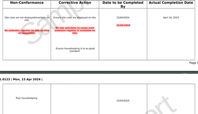

What I want to achieve is all executed answers displayed in a list directly below each other and in a single line across all the cells. With the expression as in the table above, the answers end up being displayed like below, with gaps between answers which weren't executed etc.
In above, it almost does what I want, but the 3 answers should be aligned across the 4 cells and the table should be sized as such. They should also be displayed like a list one after the other in each cell.

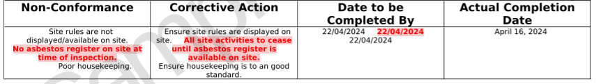

If I change the expression in the table above so that it is all together (not on a new line for each question but a continuous piece of code) it ends up displaying everything like this:
The size of the table is what I want, but everything should be on a new line/paragraph and aligned across each cell.

So in Survey123 I'm using a style of "pages dynamic-grid". The last section (last page) of this survey basically contains a summary of all of the answers to the questions. There are 51 "Yes/No" questions with Non-Conformance/Corrective Action Required/Date Corrective Action to be Completed by additional questions that are asked if any of those 51 questions is "No".
The Summary Table in Survey123 looks like below.
For example, this Summary shows that Q1, Q3 and Q5 were answered "No" and displays the follow on questions. All of the other questions were "Yes". I need to get this summary table into the feature report and for the most part it works using the expressions I wrote above. However what ends up happening, is when the Feature Report is generated, that table spreads itself over a whole page or 2 and is filled with a whole pile of white space between each of the answers and often doesn't align in a row like the s123 summary table above.

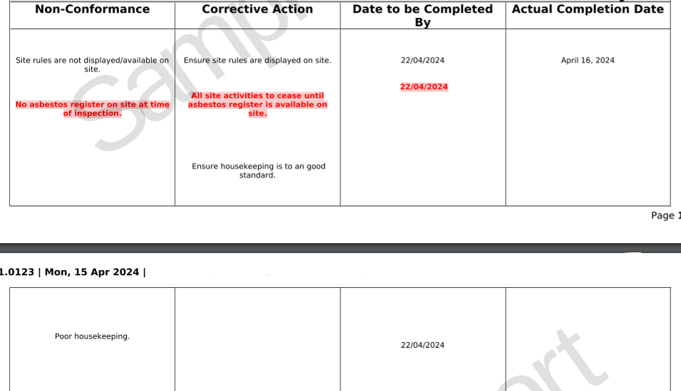

There is a serious bit of info with this survey so I'm trying to make it as concise a possible to explain lol. I've attached a copy of the Feature Report Summary Table as I have it atm. Also attached an example (different answers to above but that's irrelevant) of how the output summary table looks when the feature report is generated. Its across 2 pages and doesn't look great.

I have tried doing what you suggested above, but the problem with that is that it ends up looking like the attached (empty cells if those questions were answered Yes). That was why I tried putting the expression into a single cell under each heading in the table. i do like how it keeps everything aligned however, but if that could be done without individual cells it would look better.
It's a complicated one 🤔 maybe this is a limitation of the software, but I'd have thought it would've been possible given how obvious a requirement it seems. Do you have any more thoughts?
