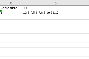

i have a begin repeat in my form, I have two questions. (select one)
1. please choose a fibre cable: Answers: 1 -10  (Select Multiple)
2. Please chose a POE: Answers 1-12
How can I when I export the data to an excel that the POE answer goes onto the next row instead of being bunched up in one cell with cable fibre matching in row C

That looks correct?
Repeat = new table.
Then each repeat entry will create a new table row. Your two questions will be columns in that table.
Select one = one value in a cell.
Select multiple = multiple values separated by a comma in one cell.
So the screenshot appears correct. If you're seeing something different or expect a different result please clarify.
