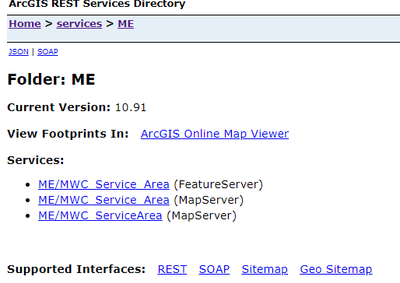

BrendonJoyce1
Hi @ZacharySutherby
It appears I can open this directory without login, and it only shows the public facing layers as it should:
As for the non-public surveys - yes I can create reports through S123 Portal site - This is my workflow now, to manually do this.
