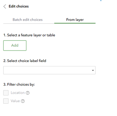

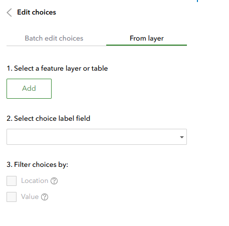

When adding a layer for the Dynamic Choice Lists it says it accepts "Feature Layer or table" but when adding a service with a standalone table in it the results are empty:
Adding a layer for a dynamic choice list:

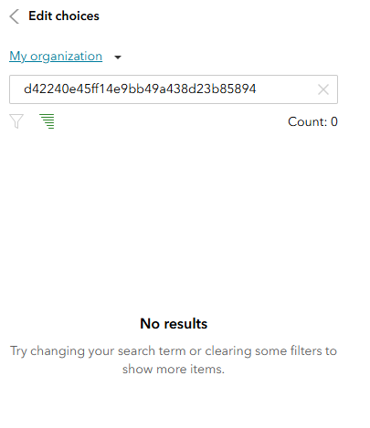

Searching for the hosted table, no result:
