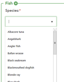

Hello,
We have a link to a Survey123 form in an arcGIS Hub site. When this form is accessed using Microsoft Edge (Version 91.0.864.53) the dropdown options appear to be disabled. The dropdown arrow appears to be greyed out.
If I start typing in a species, the relevant options will populate but I cannot see the entire list.
The form works fine on other web browsers e.g. Chrome
The other elements on the form (radio buttons, date pickers etc.) are all working fine in Edge.
Any help on this matter would be greatly appreciated.
