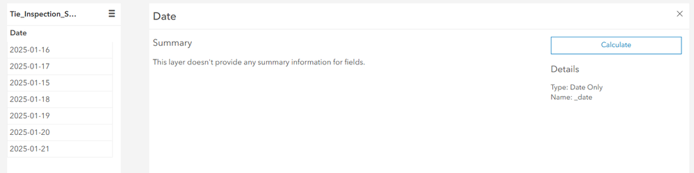

RMill
So went to AGOL, this is from the details page of that field from the "results" feature service (since its shared). Still shows as a date only type.Screenshot 2025-01-22 151822.png
DougBrowning
MVP Esteemed Contributor
Mmm  maybe 123 has support but not the reporting.  @ZacharySutherby ?
