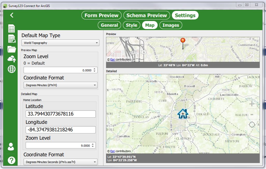

The following bugs have been addressed and fixed from your test results, all fixes will be released in the next 2.0 release (early April).
  • If I publish a new survey with no extent set, the map appears in the Individual Response section but the map shows the whole world
    • This is a behavior by design
  • If I republish the same survey with Preview Map and Detailed Map options configured, the map still appears in the Individual Response section but is centred over the west of the US
    • Bug: This will occur when setting a zoom level in Home Location of the map in a Survey123 Connect survey to a decimal value. Fixed: now both decimal and integer zoom level values will work.
  • If I publish a brand new survey, and configure Preview Map and Detailed Map options, no map appears in the Individual Response section
    • Bug: This will occur when setting the Default Map Type of the map in a Survey123 Connect survey to "World Topography". Fixed: now all map types in a Survey123 Connect survey will work.

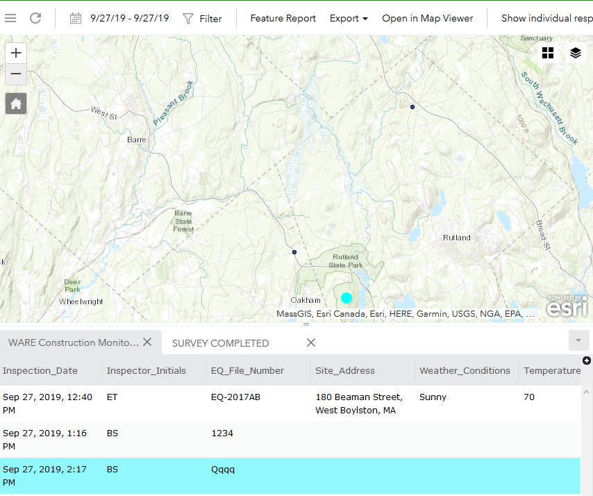

I realize that this post is from a long time ago, but I'm noticing some weird behavior that is related to this topic.
I published a new survey on top of an existing feature service today. Within Connect, I customized the map extent settings. I collected some test data, and the survey works perfectly and my collected geopoint shows up exactly where it should. When I go to the Survey123 website and view the Data page for my survey, the points appear in the proper location on the map showing in the top half of my screen:

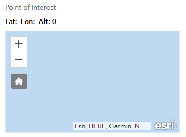

When I click on a record and the record information opens up, the map shows this:
This survey also has a custom report template; the map within the report template also shows the Point of Interest as having no location (it's showing a piece of ocean off the coast of Africa, AKA the 0,0 coordinate).
I'm not sure what's happened here, or where I've gone wrong. Any suggestions would be appreciated.
