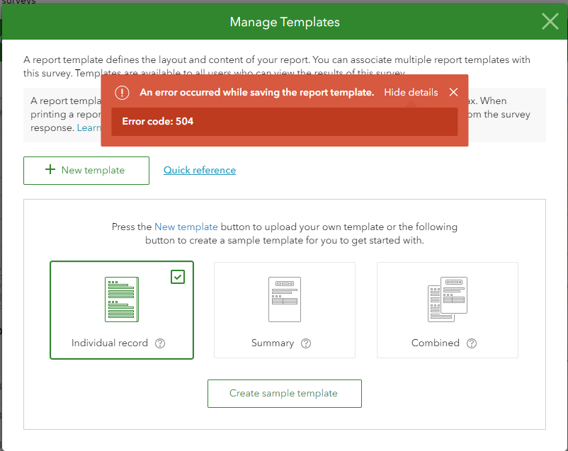

I am trying to create a report for a survey that has approximately 40 records.
When I try to create a sample template in manage templates, I receive an error message that states, “An error occurred while saving the report template” The error code is 504.
I was able to create a sample report template in two other surveys, so the issue is with this survey.
A web search for the error code has been less than helpful.
If you have run across this issue before any advice would be appreciated.

Hi, we are also getting this error today for one of our surveys when trying to generate a report using the Survey123 REST API. We are geting a 500 Internal Server Error code. So something on the ESRI side broke all of a sudden.

TommyBarnes
I just checked and I am still getting the error message.

Ruth_JiatengXu
Hi @PanjiBrotoisworoIntrax @TommyBarnes
This issue occurs on the multi-lingual survey published using Connect. The fix for this issue is available on BETA. Could you please help try it on our BETA env https://survey123beta.arcgis.com/?
If this fix solves the issue, we will deploy it to prod with hotfix1 build.
