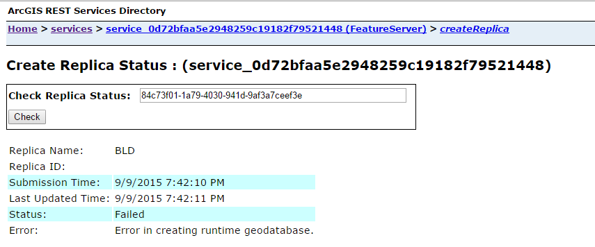

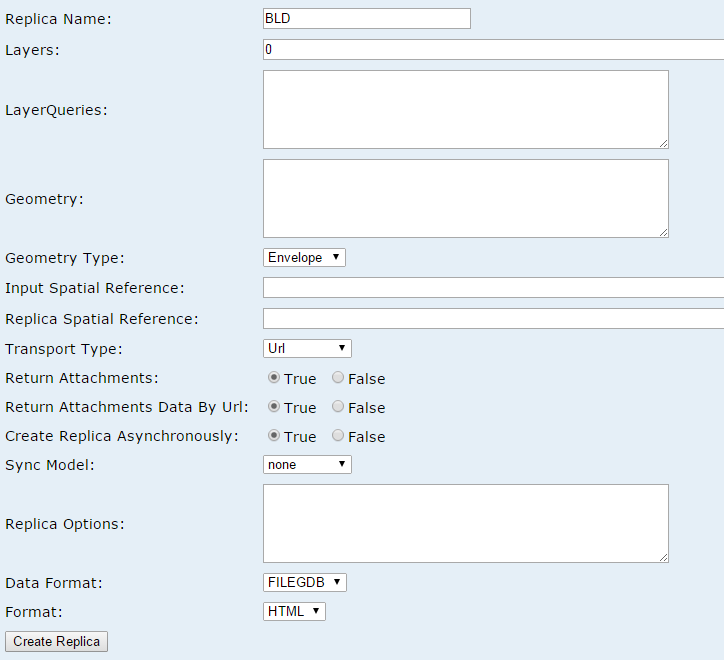

Also, When I try to create a replicate file geodatabase of the content using the service URL - it fails.

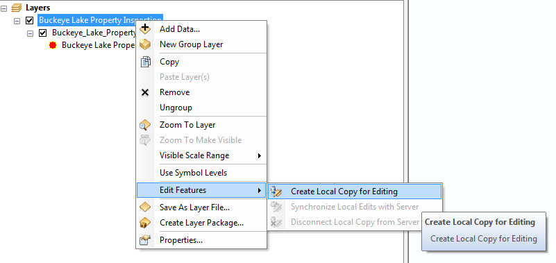

I can create a local copy for editing from an ArcMap environment successfully...

Thanks for sharing the form. I tested this in my account and I got the same error you get. I was only able to export the data to shapefile or CSV. I understand you want a file geodatabase so you can get the attachments as well.  This is an issue in ArcGIS Online. I asked the ArcGIS Online team to have a look.

A case was created and assigned to me in technical support with regards to this issue. After some troubleshooting with the data that Daniel provided, I was able to determine the source of the export failure in ArcGIS Online.
As you can see in the attached images below, the name and label fields contain duplicate values (Stucco). When the service is published to ArcGIS Online, this will cause a problem as coded domain values will be created based on these values. Therefore, if we delete one of the duplicate records, the export issue in ArcGIS Online will be resolved.
