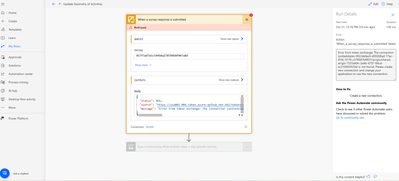

We are not seeing new submissions to S123 triggering our Power Automate Flows.  Everything in the flow looks fine - connection is valid and show list of surveys, it saves ok, and we see a webhook in the survey123 website.  In the run history, we do not see the failed runs, but Power Automate indicates there is an error, and gives us this message:
Anyone else seeing this issue?

The error message indicates a problem with the token.  How intermittent are submissions.  It appears tokens are valid for 14 days
https://community.esri.com/t5/arcgis-survey123-ideas/make-the-token-for-survey123-valid-indefinitely...
https://doc.arcgis.com/en/power-automate/latest/get-started/faqs.htm

I'm getting this after creating brand new connections on brand new flows.  And within the flow everything looks normal and it saves fine.  So, I don't think that is the issue.  I'm wondering if there is an issue with the authentication service, webhook url, or something like that.
