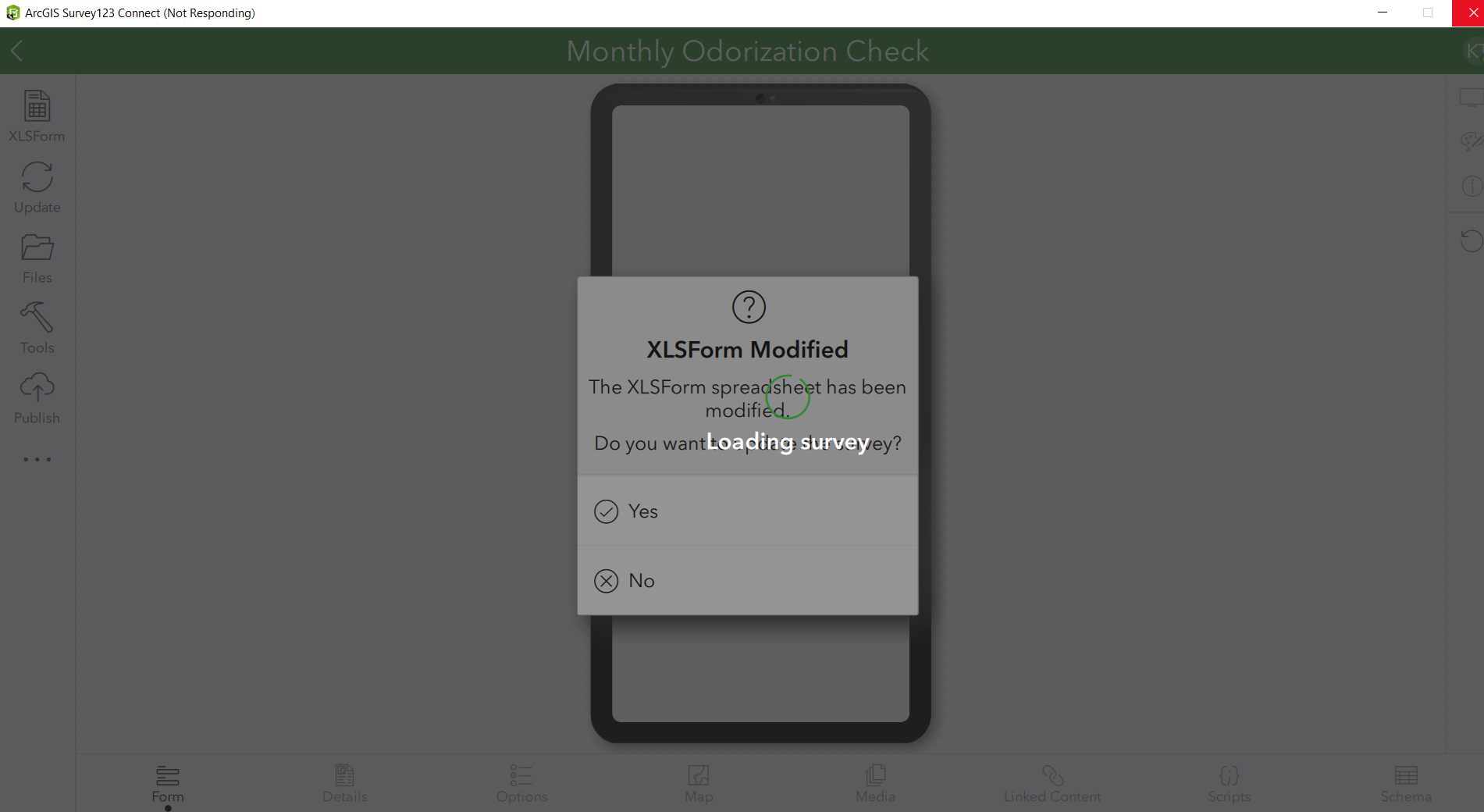

Hello hello,
As the title says, Survey123 Connect is stuck on the "Loading survey" screen once I try to open a survey for editing. The problem seems to be specific to one survey as I am able to open others without issue. I've restarted connect several times and even restarted my machine (even though I didn't think that was the issue). Has anyone had this problem before?

I have a similar issue that I'm fairly certain is caused by a very large select one option that wasn't configured to be autocomplete. I've fixed that now, but it still hangs up before I have the option to update the form. Any ideas on how to bypass that without having to make a new form?
ZacharySutherby
Hello @DietrichEppSchmidt
When you're on the main gallery in Survey123 Connect select the three horizontal dots for the survey you are running into the issue with. Then select "Open folder", when the folder opens delete the <formName>.xml file. Then select the survey in the Connect gallery and you should see the XLSForm Modified message, select Yes to re-convert the XLSForm with the autocomplete change and regenerate the XML file.
