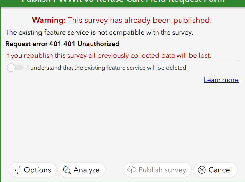

Hi, I am using Survey123 Connect.  In an existing XLS Form, I made one change, I added a default value to a select_one question.  I saved the form.  When I went to publish the survey, I was greeted with the 401 message.  I canceled the process.

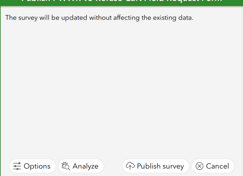

I then pressed Publish again, and was greeted with this message, A-OK to publish.  I canceled the process.
I clicked Publish again and was greeted with the 401 message.  I tried this a few more times and watched the messages toggle between 401 and it's OK to publish.
If I remove the default value, save the form, and go to Publish, I get the same toggling behavior.  If I am in the 401 message pane, and accept the warning and publish, I will wipe out 600 collected data points.
