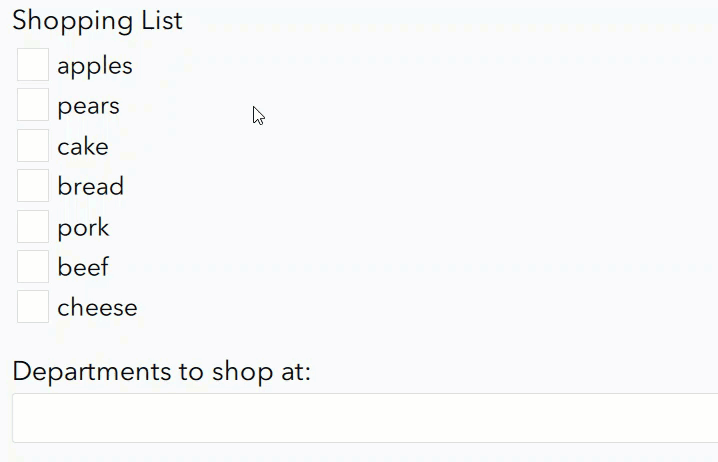

JenniferAcunto
That is how if statements work, once one of the statements evaluate to true, it stops. You likely want to set up multiple temporary fields to do each if statement separately and then combine them into a single field.

JenniferAcunto

DarrenLloyd__DOIT
I got everything configured using your example. Thank you!
