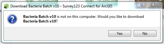

I was making a few updates to some surveys this morning, and suddenly Survey123 Connect was not finding my survey designs. As in,  I cannot open the surveys at all.  I checked, and everything is there in C:\Users\lberni\ArcGIS\My Survey Designs.
Here's the warning when I try to open a survey:
Also, any new surveys that I just created are not showing in Connect at all. They are, however, being saved in the My SurveyDesigns folder.
I'm using Connect v 3.0.142, which I updated to several weeks ago.

Hello Lynn,
Could you please try renaming the "My Survey Designs" present at "C:\Users\<user_name>\ArcGIS" to "My Survey Designs_old" and relaunch the Survey 123 Connect application.
This should create a new "My Survey Designs" folder and should allow you to download the Survey forms.

This happened to me yesterday as well. Like you've noticed, you haven't lost your surveys but Connect isn't reading them for some reason, which is super frustrating. What I did in the short term was start up an earlier version of Connect that I still had installed (I keep all the old versions just in case) and it found all the surveys and I was able to edit/publish. And today, the current version (3.0.142) was working again.
For what it's worth, I first noticed the problem when I signed-out of Connect (keeping the program open) so that I could 'see' a form I was working on that I hadn't published yet. That's when everything disappeared (in Connect).

As you suggested, I renamed the folder to My Survey Designs_old. When I restarted Connect, it created a new My Survey Designs folder and I was able to download the ones that I've already published.  I had to recreate the one I was working on (that isn't yet published), by copying the xls form from the "old" folder.
