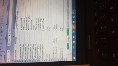

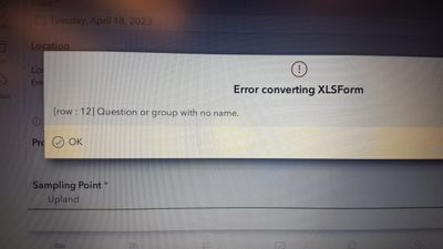

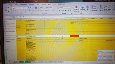

Hey James I have question for you if you have the time.  I have a select_one question called select_one normalCircum and I also have that in my name column normalCircum
In my choices tab I have normalCircum and 2 options for it Yes and No.  What I want to happen is when you select No a text bar appears to allow you to explain why.  Do you know how I can do this?  I've attached some pictures to help hopefully
