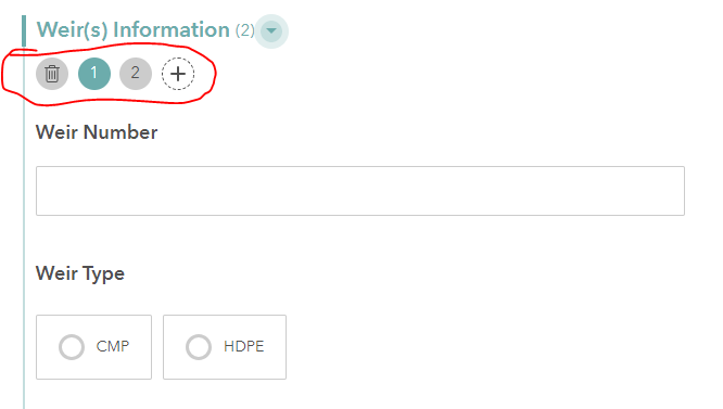

Hello. I need help formatting a Survey123 Connect XLS Form. I am trying to add a button (circled red below) that duplicates the 'Weir Information' group in my XLS Form. The goal is duplicate all the questions in this group so that I can add and complete multiple weir entries in my survey when I am out in the field collecting data. How should I format the XLS Form to add this button? Thank you, Bailey.

you are looking for the 'begin repeat' and 'end repeat' question types.
here are some links for more info:
Repeats—ArcGIS Survey123 | Documentation
XLSForm Docs

Thank you, Clay. This is very helpful!
