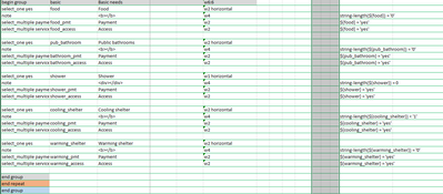

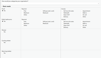

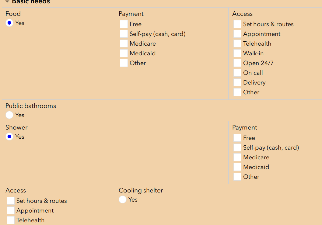

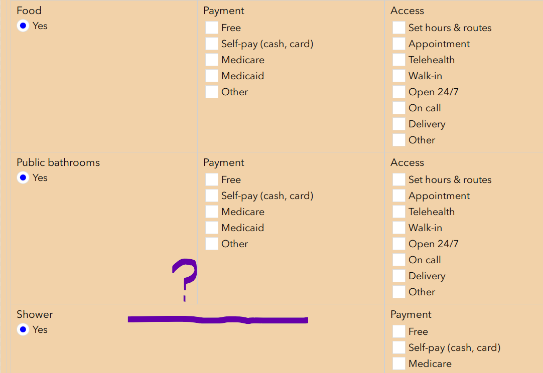

Howdy! I'm having a problem with the grid width settings (w# appearance) working in some rows, but not others. The settings work for the first couple rows, but get thrown off on subsequent ones. The grid is in a w6:6 group, within a w6:6 repeat, within a w6 group, dynamic layout.
  • The first column is select_one, w2 and always displays.
  • The second column is a note, w4, and should only display if nothing was selected in the first column.
  • If the first column is selected, then 2 select multiple, w2 columns should display instead of the note.
  • Display is controlled by formulas in the 'relevant' column
  • Fixed-grid is not an option because the number of multiple choice options creates a wide gap between rows even if column 1 is not selected
This works for the first couple of rows, but then it seems as if column 1 takes up more than it's allotted w2 spaces. If column 1 is selected, it takes up w4 spaces, pushing the first multiple over to the last w2, and the second multiple to the next row. The problem may have something to do with the note displaying anyway; if no selection in column 1, column 1 takes up all 6 columns and the note takes the next row. If the first column is selected, the note appears to take up the middle w2.
I can't figure out where the problem is. Any ideas? Screenshots and xlsx file attached. Thanks!

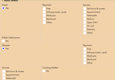

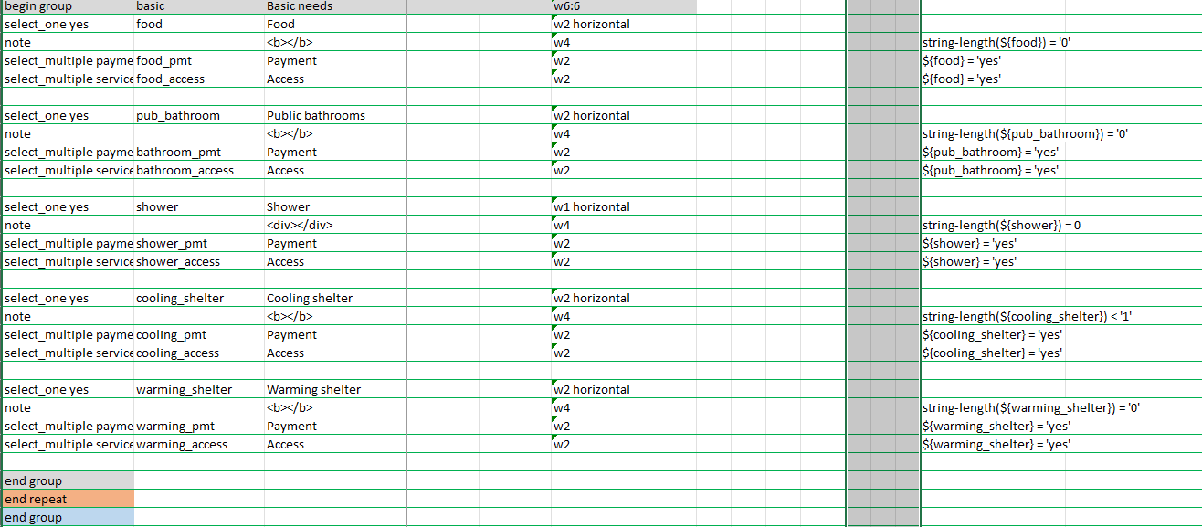

TylerGraham2
The thing with adding additional groups with no labels is that it gives you an error message in Connect and if you do something like <b></b> you get extra white space in the form of an empty group header.  One thing esri has conditioned in me is an unhealthy paranoia when an error/warning message happens and the thing still appears to work.  I know it is going to break at some point in and in an unexpected way later down the road.
I took a stab at it, and it was giving weird formatting on the shower question too until I took out the whitespace notes. With they dynamic-grid the questions then bumped around all over the screen which in my opinion would drive users nuts.  I set just the basic needs group to a fixed-grid using the body::esri:style column in the xls, but then like you said you had all the space between the questions. The reason that was happening was the select multiple choices were long vertical lists.
In the appearance you can adjust how many columns the choices appear in (separate from the grid layout) with certain appearance types.  Compact is one of those, and you define how many columns you want for the list by adding a - and the number of columns, so I did "compact-2" to use the space more efficiently.  I changed the Basic Needs group to w5:6, so it is 5 columns spanning the 6 columns of its parent group.  I changed the select one questions to a w1 which frees up some screen space for the select multiple questions (still left as w2).  Below is what you get as a result.  I attached an xls with the setup to review.

Neal_t_k
MVP Regular Contributor
Non relevant fields take up space, to overcome this each section can be its own group, that way you don't get overflow issues into the next group.  Try the attached out.
ZenMasterZeke
Thanks @Neal_t_k. I'll take a look at your file. I thought that dynamic-grid was supposed to collapse non relevant fields though, and it appears to do that for the first two rows. Also, the first column is w2, the note is w4, so presumably that would fill out the 6 column grid. But if I put actual text in the note, rather than <b></b> or similar, it displays below the first column, as if the first column is now w6.
Neal_t_k
@ZenMasterZeke I have always had to fiddle to get relevant grid questions to act the expected way.  They seem to "collapse" but still take up some space.  Using nested groups is always how I end up keeping those questions separate and avoiding the spillover.

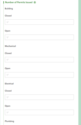

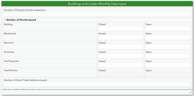

apgis16
I'm trying to do a grid layout in S123 Connect and it looks fine in the preview but when I publish and view it in the web browser, it doesn't show a grid and it's driving me crazy. Below is the spreadsheet and screenshots:
apgis16_0-1770237263366.pngapgis16_0-1770237263366.pngapgis16_1-1770237285107.pngapgis16_1-1770237285107.png

TylerGraham2
Use field-list instead of table-list for your group appearance.  table-list is supposed to be for a group of select one questions.
https://doc.arcgis.com/en/survey123/desktop/create-surveys/quickreferencecreatesurveys.htm#:~:text=N...
