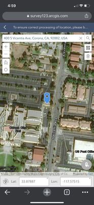

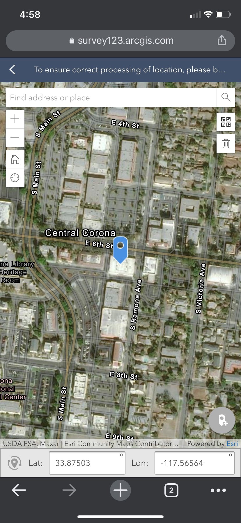

Drop a pin in the location of possible code violation:

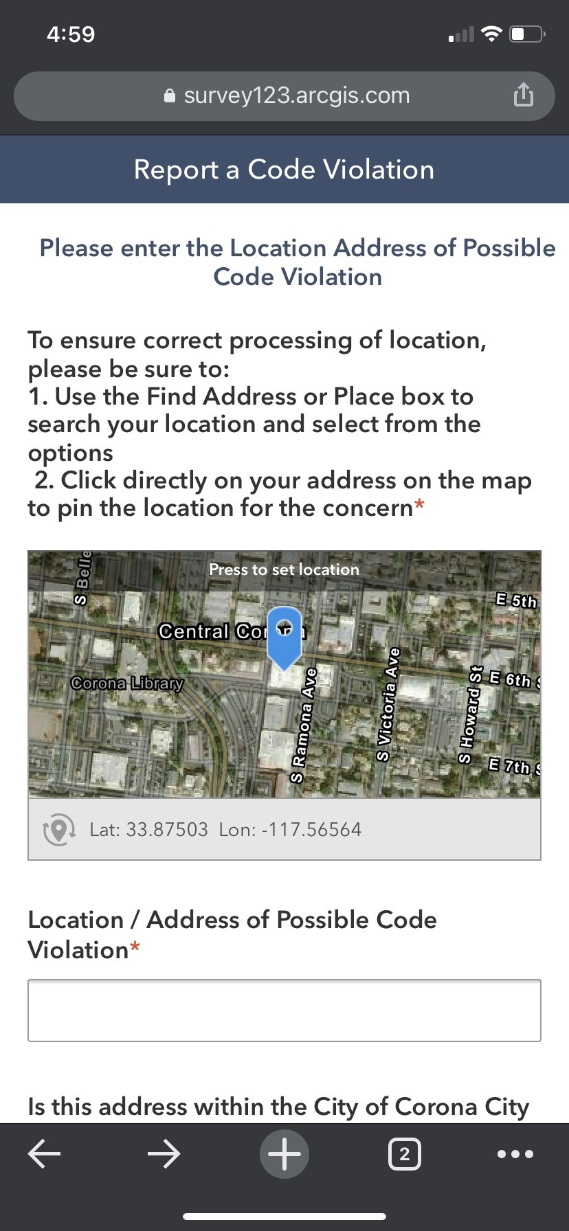

When I click the back arrow button on the upper left, the address is not recorded under "Location/Address of Possible Code Violation":

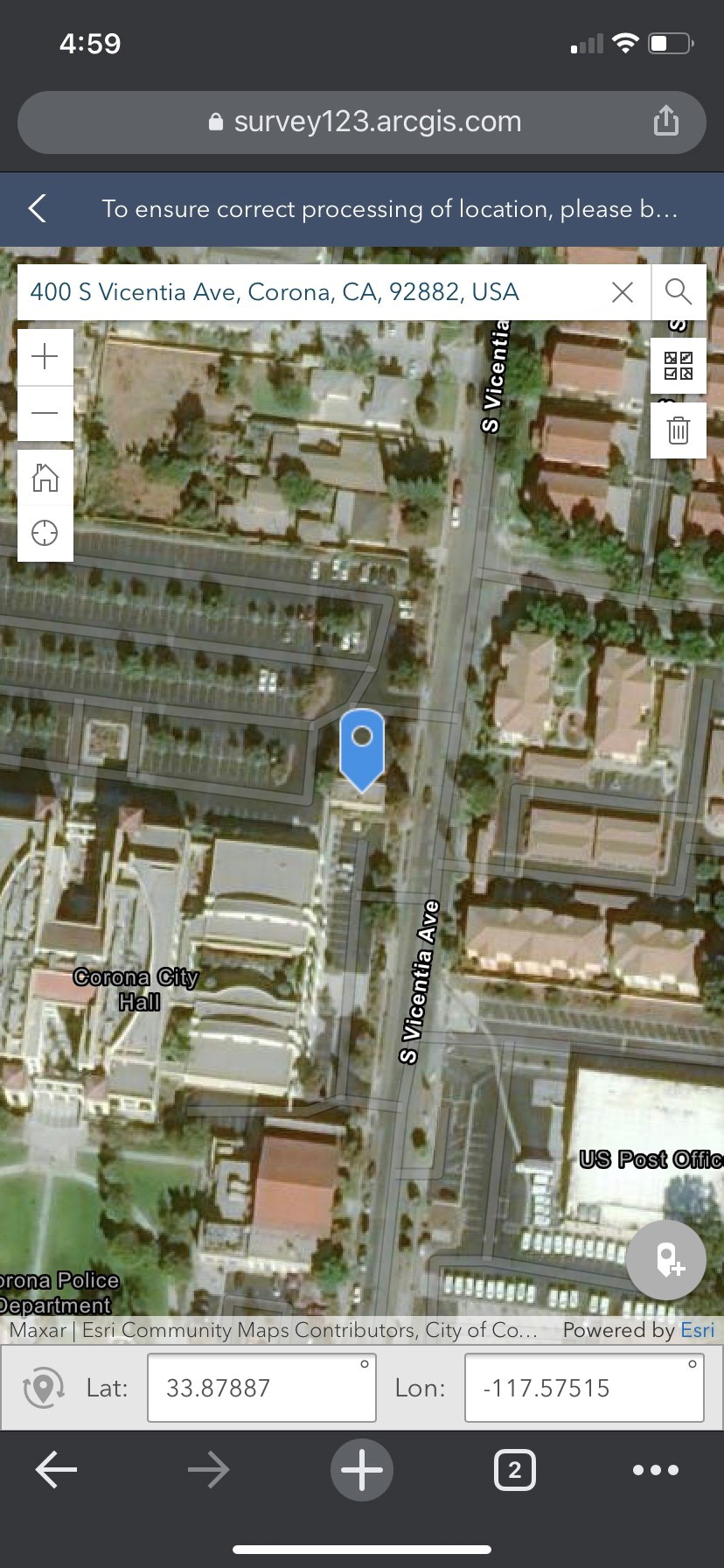

When I use the search bar to search for an address the address selected does not auto populate under "Location/Address of Possible Code Violation".

Thanks for the xlsForm. By looking at the form, you are using the javascripts with the reversed geocoding service. I was able to see the problem when the survey is made to public. If it's private, the reversed goecoding service would work on an android phone web browser. Could you confirm that you see this problem on an android device and with a public survey? We do have issue with javascript in public survey and currently is scheduled to be implemented in the next release. Before the release, you could access to the beta version from our EAC site to test the fix.
Please confirm if you had met the following scenarios:
1. Using the web browser on android.
2. Survey is public.
