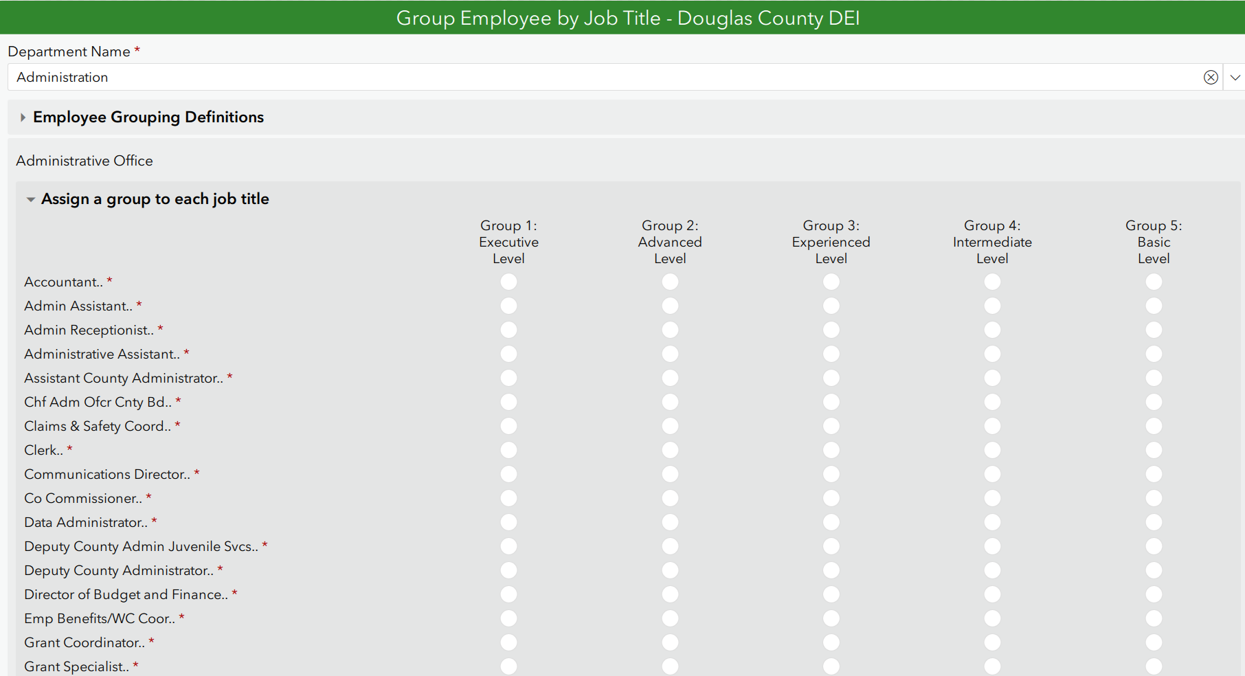

I am trying to publish a survey from Survey123 Connect to Enterprise Portal, and I keep getting a timeout error. Its relatively large survey (over 700 fields). I have tried to add repeats to break it down into several several tables, but I'm still getting the same error. The survey has a number of groups with table-list appearance.
The first question in the survey is Department name (user selects from drop down). Second questions is a note. And third question is a number of questions 'grouped' together. It depends on which department is selected in the first question, a list of job title is show for that department. In here user has to select to which 'Group' each job title belongs to.
I checked the field names, field name length, and anything I can think off, but cannot publish the survey. I created a smaller subset of my survey, and was able to publish it successfully. It makes me believe that the issue is with the size of my survey.
Here is a image from the survey:

Thank you for your suggestions. I tried zipping up the survey folder and was able to successfully upload it to the Portal as Desktop Application Template. I also tried publishing the survey to AGO and was able to publish it successfully.
I don't believe we have any upload limits set up on the webserver. Unless there is something specific you can point me to?
