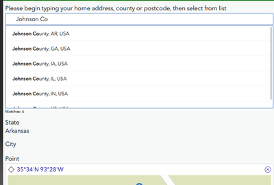

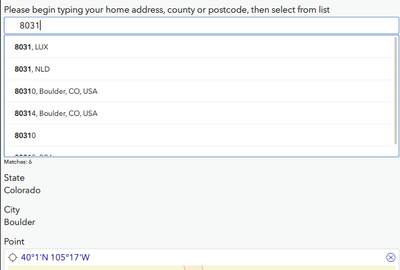

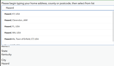

There's no need to enter basic geographic information such as counties. You can simply set up a geocode question and let people enter their county, postcode or home town and the location will be automatically  and accurately mapped. See the attached xlsx.
