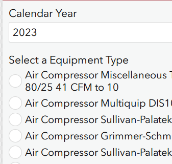

You shouldn't need the search() appearance at all if all you are just filtering a list. Instead, use choice_filter. Your current choice filter is set to a column with all the same data. I.e., If you enter anything other than "2023" you will get nothing. If you enter "2023" you will get everything:

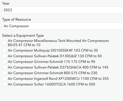

That makes the filter pretty easy:
selected(${CalendarYear},YearOfRate) and selected(${ResourceType},Resource)
Results in:
It appears that your CalendarYear and ResourceType fields are hidden calculates. If you use this choice_filter for your dropdown and experience any issues, ensure that 1) you have filled in those fields, and 2) those fields are returning the expected data. You can always temporarily show those fields for testing to ensure they are doing what you want (similar to my example above).
