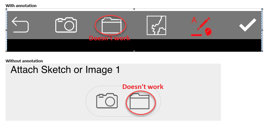

We are using the AppStudio version of Survey123 and it appears that we cannot attach a file on either an iPhone or iPad after upgrading to iOS 13.  When I select the icon folder the screen just freezes.  I have tried to dig into the code, and think it has something todo with te xFormPictureChoose.qml, but wondering if I should continue my investigation or whether a change is in the works?  Both with and without annotations don't work on a survey attachment on iOS

This is a related issue.  The original bug was using the Beta version of iOS 13 and we had a workaround.  Now with the actual release of iOS 13 our workaround does not work.  We need to update our Survey123 template code with the fix that QT comes up with in that picture chooser file.  Any immediate help with this or updates would be great.  Our users rely on uploading pictures using out modified survey123 app.

It still has the problem when running it in AppStudio Player on the iPhone.  Are you saying that the cloudmake result would be different than the version that runs from AppStudio?  Also, i need to build my app using the local make, would the local make files have the changes updated as well so my resulting file would work?
