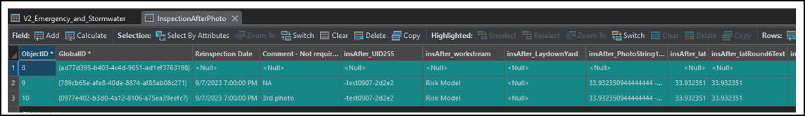

In previous versions of Survey123
We could compact a repeat, and if the field crew didn’t open the set of questions, the record wouldn’t populate with NULL data.
Version 3.18
This version adds a record of NULL values, which does two things;
  • It makes the report ugly by adding a record for the NULL data (unless you add an if statement)
  • It will also charge us more credits for having NULL data in the cloud.
Let me know if there is a fix in the works for this OR is there something I'm doing wrong?
