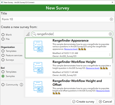

There are a few rangefinder samples in the Connect sample gallery that might help rule out any XLSForm configuration issues. You also may want to make sure your Survey123 field app is at version 3.18.123 or higher since that's when the rangefinder support was added. You may have already seen it, but this video also shows a few workflows using the sample surveys.
