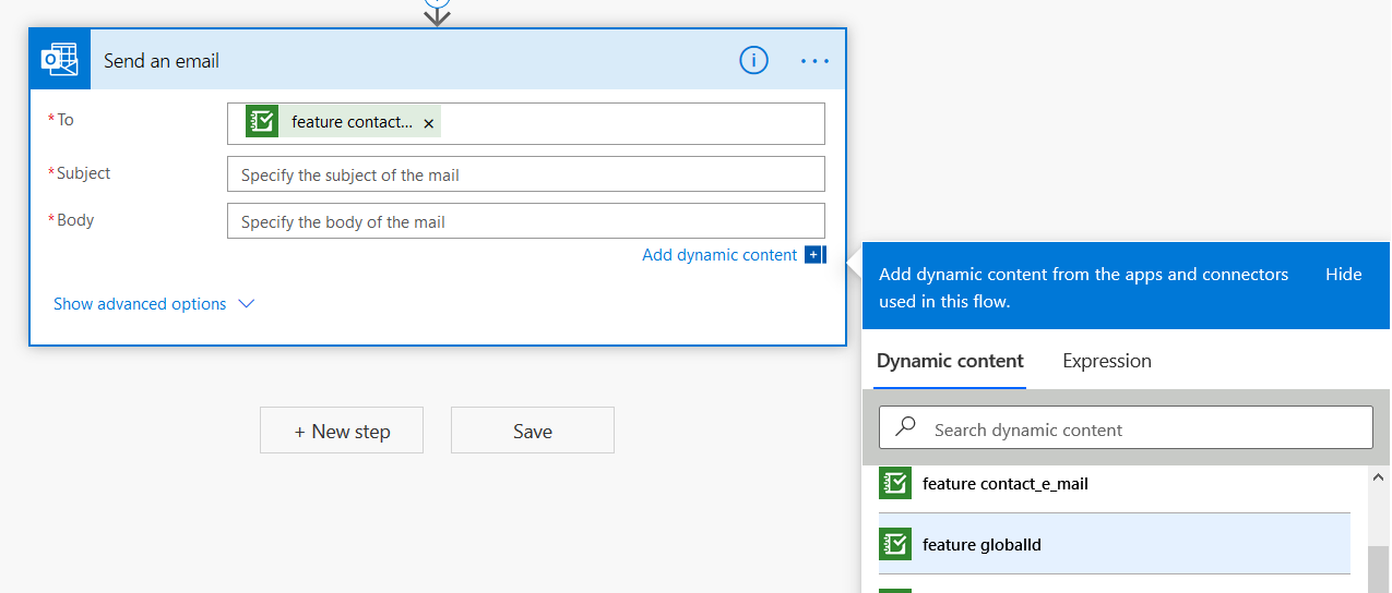

That was it exactly!! Thank you Isreal... if possible, do you know how to include a link to that particular survey response so that the recipient may make the necessary changes? thank you again!
IsmaelChivite
Esri Notable Contributor
Sure. If you want to include a link in your e-mail so the recipient can re-open the survey to update information, you need to know the globalId of the feature that the user submitted originally, and add that to the link of the survey.
