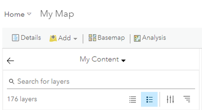

@KansasDASC, what I've done for this in the past is configure a blank Field Map from scratch and simply bring in the feature service/layer (you may need to search for it with the Add --> Search for Layers menu) from the existing Survey123 deployment.  Then save the Field Map with a name similar to what's being used for the Survey123 Form name.  This sets things up such that observations can be submitted within the Survey123 app and allows users to then just pivot over to Field Maps for additional viewing/editing of the submissions.
