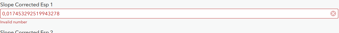

We are struggling with Survey123connect and the Survey123 app adding a comma as the decimal separator to decimal fields when it calculates a value or pulls it through from another field.

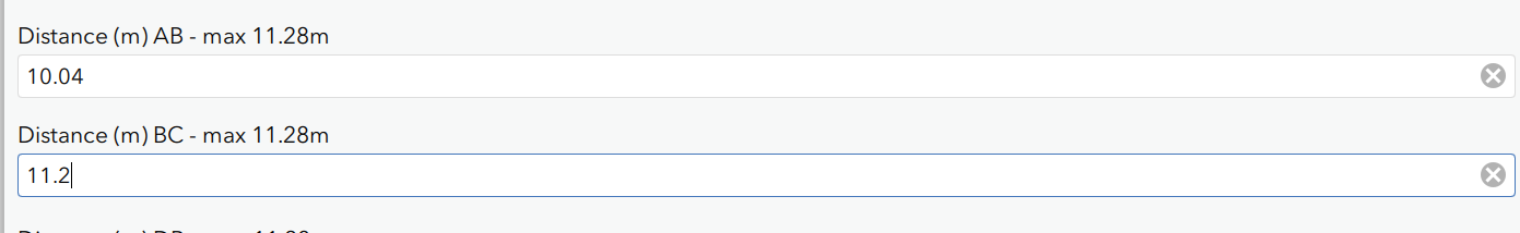

When I type into Survey123 decimal field it allows the decimal point:
When it has calculated the field it uses a comma, and gives an error:
When I have a calculated field using the first example, the calculation does not work and returns a null when I have a decimal point in place. It is expecting a comma. It does not allow me to enter a comma however, as the decimal separator is a point.
