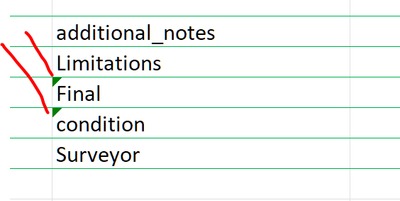

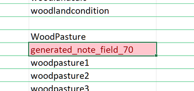

You have several dup field names like generated_note_field_70.  You also have several using reserved words like label and final.  You also end some in _ which is not a good practice.
Looks like you are not using the template is your biggest issue.  It will check for all of this for you and mark then in green for reserved.
And in Red for dups.
I suggest you start with a brand new blank template and bring over each column - MAKING SURE to use Right click Paste Values.  This way the formulas in excel to check all this is not overwritten.
Then all of this is easy to see.  You never want to mess up the template.  Not even sure how\why you did this.
