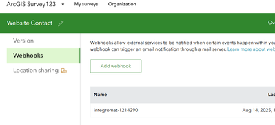

I believe I have fixed the issue. It appears that the survey had too many webhooks attached to it. I turned all of them off and hooked up a new webhook to the survey. Now, with only one webhook on the survey, the survey and associated Make scenario work as designed.

MicahWilliamson
Just putting this here incase I forget how to fix this again. JD242 above is talking about 'too many webhooks' in the Survey123 survey, Not Make.com
