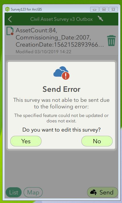

I have an issue with a survey on an iPad that will not send. I've tried a few of the suggested fixes but no luck so far - any other suggestions appreciated.
The survey itself is set up with repeats and select-multiples, and has the Inbox enabled - I think these have all been a potential source of problems in the past but the survey has been created/collected in a recent version of Survey123 so should be fine. Surveys collected before and after this one, using the same version of the survey form and following the same process, have all worked without a hitch.
The survey data has been collected by two different people, so the records are sitting on two devices (they shared the survey using the Inbox). The same issue is affecting the data on both devices. Initially the 'parent' record uploaded fine, but none of the 'child' repeat records could be sent. I've since deleted the parent record from the Feature Class in ArcGIS Online and tried sending again, but now nothing is being sent.

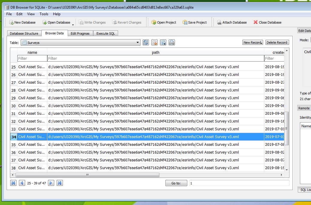

I've been able to copy the sqlite database to my desktop and open it on the desktop version of the app, but get the same error message when trying to send it (first image below). I've also tried opening the database using DB Browser for SQlite and checked the filepath but all looked OK (second image).

Hi Graham,
The specific error is that the feature that is being edited is no longer present.  This could be either the parent feature or one of the repeats that has been edited.
One method to export the data and begin a manual reconciliation would be to use https://github.com/tedrick/ReadS123DB  to export out a set of CSVs of the data; you could then compare the features in the updates tables to what is present in the geodatabase.
