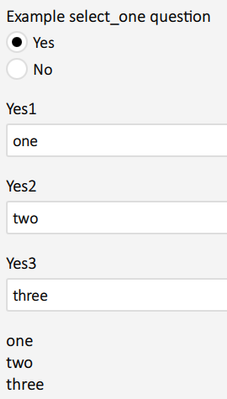

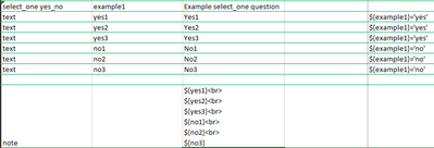

I made a survey similar to yours:
When I publish and run this on the Survey123 App it works as expected. If I choose 'Yes' in the select_one then my "yes" questions are relevant. If I then fill in values for the "yes" questions and later change the select_one to "no" then those "yes" questions are cleared out as expected.
I know they are cleared out by using a note field to view their contents:
Capturing "yes" values:
Changing  my option to "No":

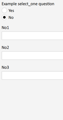

Note field is empty.

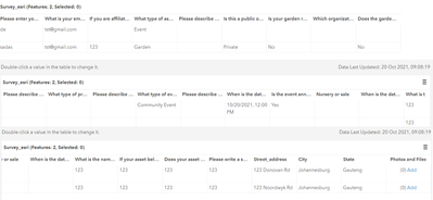

Also the data sent back to the feature layer seems to be as expected:
Record 1 was done by just choosing the yes option and capturing the yes questions.
Record 2 was done by choosing yes, filling the yes fields and then changing the answer to no and filling the no fields. As expected the relevant=false check nullified the data entered
