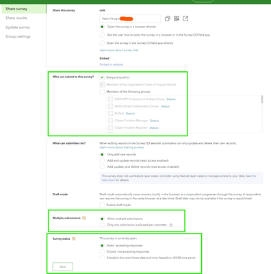

Are you using the same account in both cases? Or is it public?
Just a quick check: In Survey123 Survey Management menu in ArcGIS Online, under 'Collaboration' and 'Share Survey' settings, did you check what you have set for these options?
SriramNarasimhan
Thanks for the quick reply!
In those sections I have "member of my organization" for who can submit
"multiple  submissions"
and "open: accepting responses"
